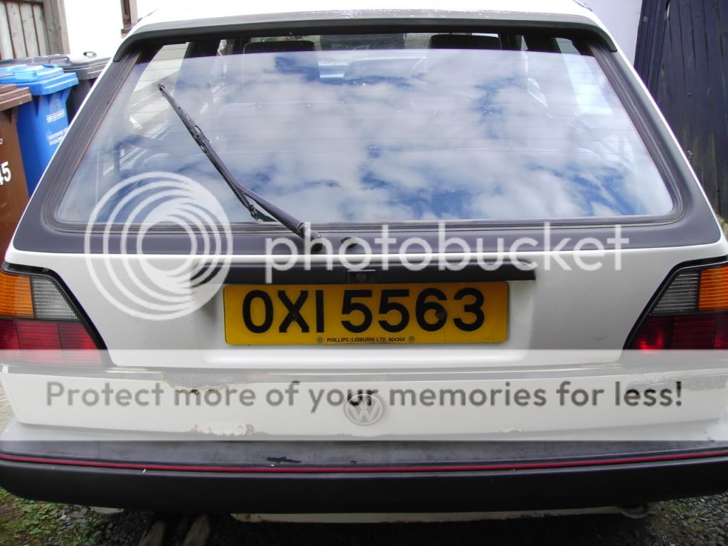

Well boys and girls sit down while I tell you a story here goes.
Once upon a long long time ago a 2 door MK2 8v GTI Alpine white was first registered here in sunny Northern Ireland, to be exact 22nd May 1989 yes the old girl is 20 years old.

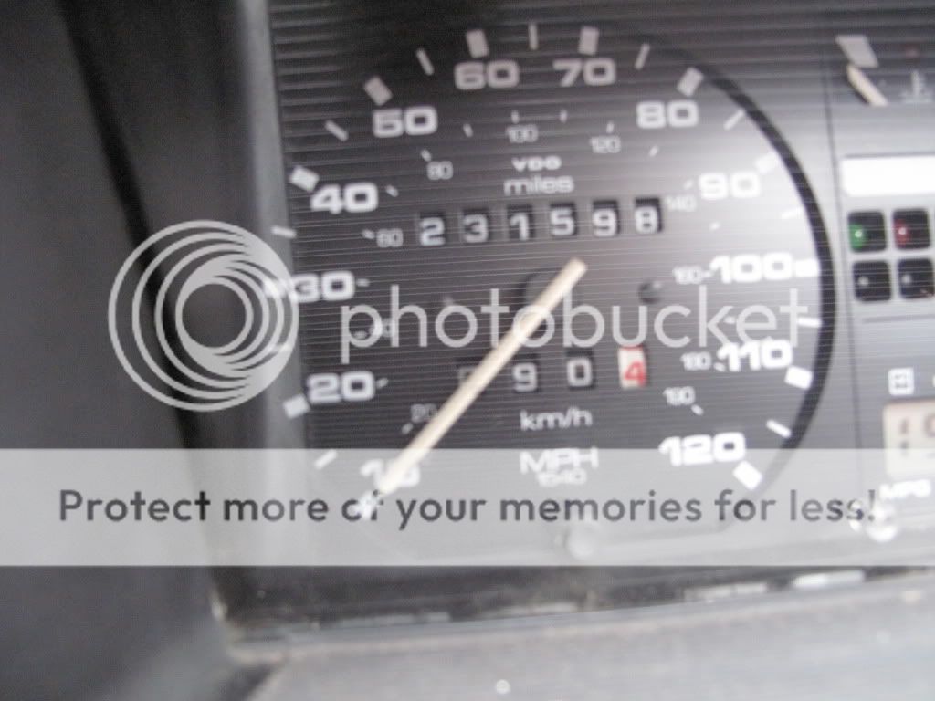

I bought her in 1992 with 47000 miles on the clock and some VW history, since then she has been my daily drive and now sits with 231598 miles! Wow.

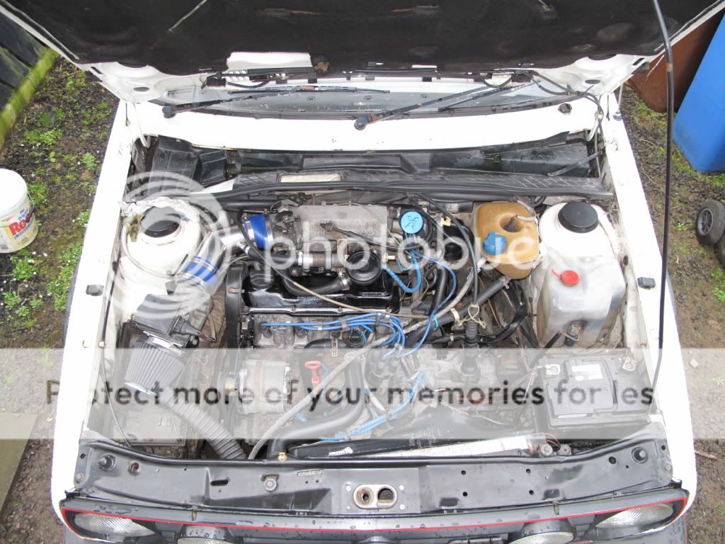

Over the years I have given her some tweaks,
Magnex stainless down pipe, Full Scorpion stainless system.
Blue Igniter leads
K&N panel filter, then K&N cone filter with stainless induction pipe.
Various cross drilled and grooved front discs and various pads.

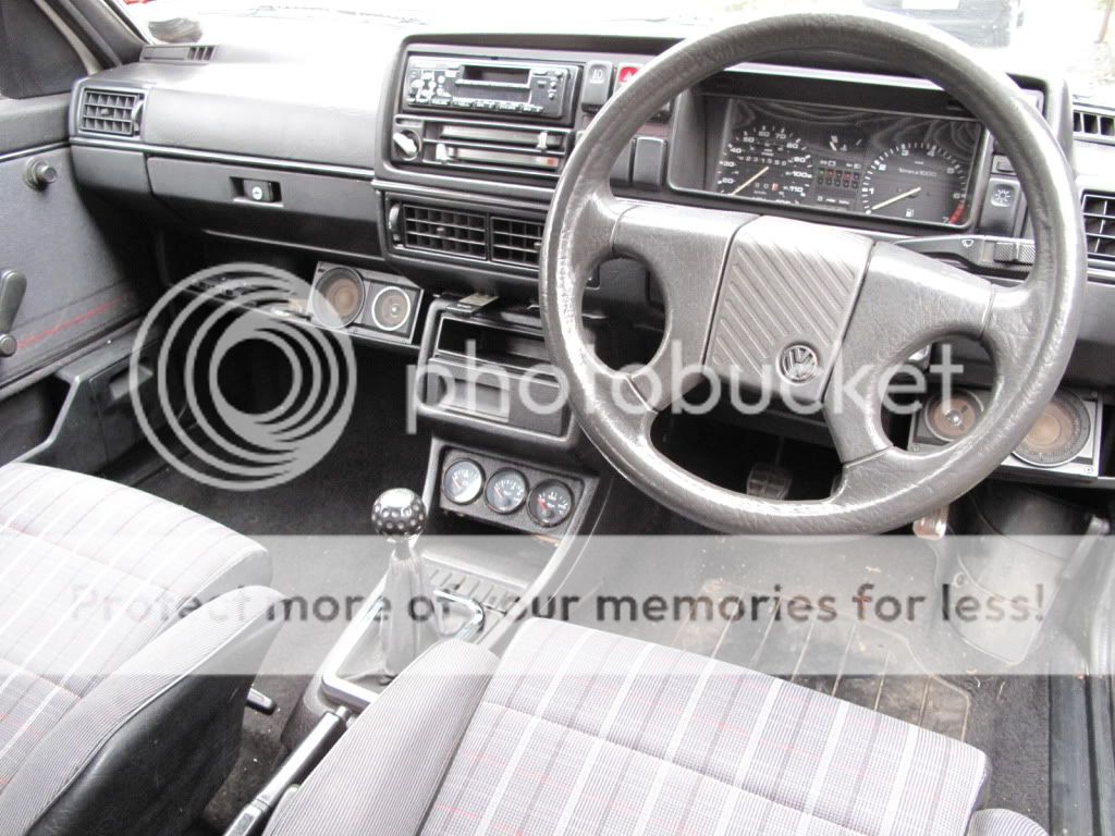

VDO gauges from an Audi coupe.
All the normal MK2 issues have also arisen over the years rear callipers, stripped and rebuilt until it became a real pain, so put new MK3 ones on and had no further issues.
Recall for heater bypass valve carried out by VW.
Drivers seat bolster and back stripped and rebuilt from a spare drivers seat from a 5 door so now good as new.
New front wish bones fitted with poly bushes. Rear top mount poly bushes
Custom leather gear stick gaiter made from the inner thigh from a pair of my then
girl friends (now wife’s black leather trousers) sweet!
Chrome gear surround. Alloy heater controls. Replaced water pump, oil pump.
The car was serviced every 10000 miles then every 5000 miles always new VW filter and VW oil and new sump washer new brake pressure valve, replaced brake pipes.
Goodridge stainless brake hoses all round.
Cam belt every 50000 miles by VW.
To many other things to list.
I have every MOT, Tax disc and receipt for anything that was ever bought for the car, a big fat file, scared to add it all up.
Now you may ask yourselves where is this all going.
Well the old girl is really showing her age and she has not been my main car for the past 2 years although Mot and taxed so I could still take her out for a burn.

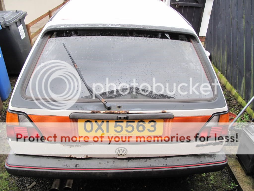

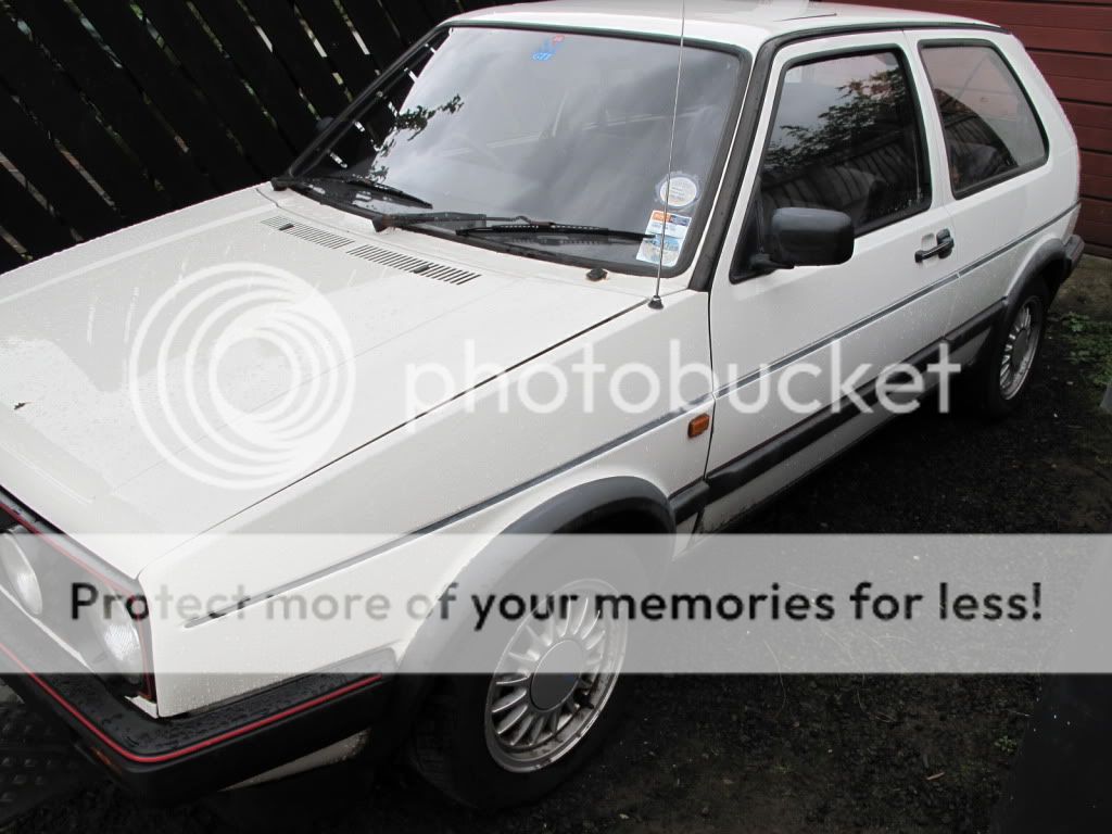

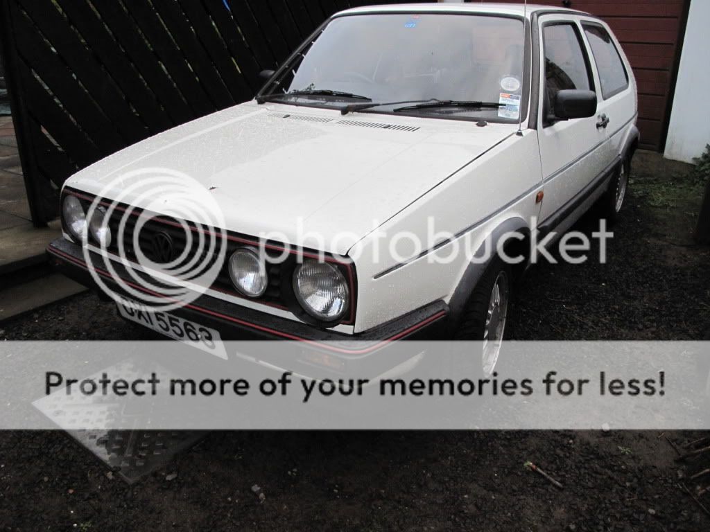

She needs some body work
New front wings and front valance, New tail gate ( yes rusted like all early mk2s),
Rear wheel arches, Sills both sides, Rear back panel ( have new VW one stored away)
New repair panel around the fuel filler.
Repair to the door bottoms both sides. New panel under battery. Rear bumper iron.
So really looking at a glass out respray and a lot of TLC to get her right.
However the pound signs look like rolling up to get her right.
The car has an mot to mid June and taxed for 6 months so need to get her sorted before it is to late.
So I need some feed back on any good body work firms who could do the work with out sticking the arm in. I have already contacted some from the various VW clubs but as yet have not taken the car to be priced, so sorry to any one I have been in contact with, just need to get off work so the car can be looked at and priced. If any one has good panels hidden away or know where to source them give me a pm,

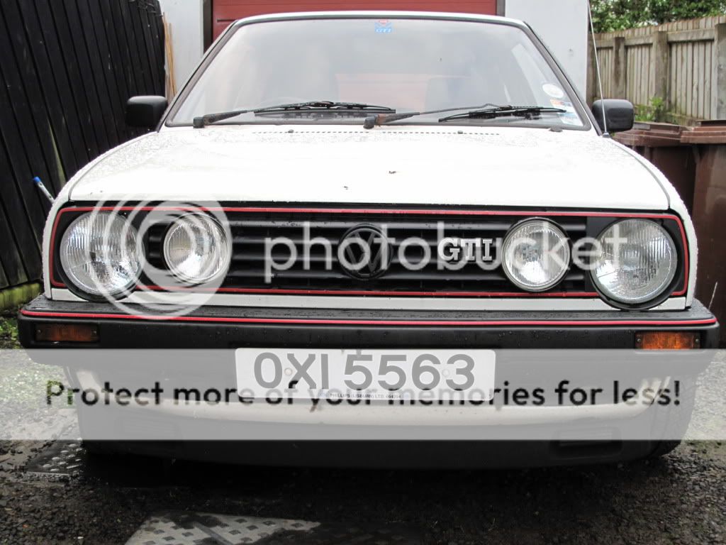

So here she is in all her glory. What would you do after 17 years?

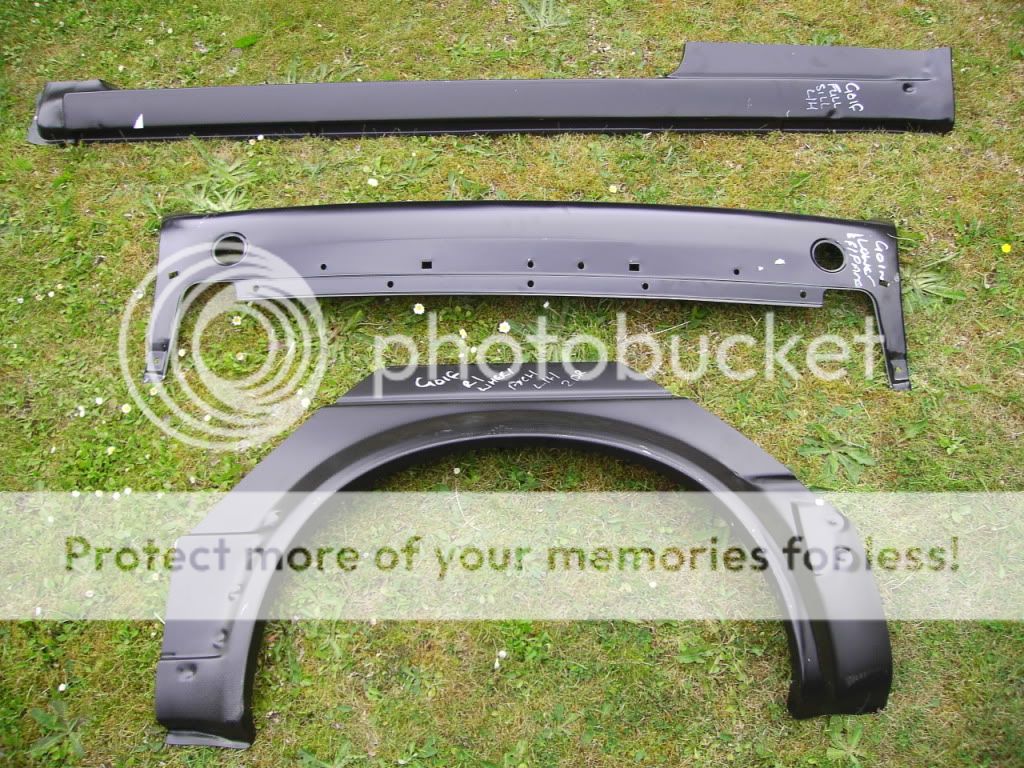

Well after a lot of ringing around and searching E-BAY I picked up the first big panel
I was going to do the sill, rear wheel arch and fuel panel, (60.00+ for these 3 panels) then all the cutting and welding, but after speaking to some body work guys they felt the best option was to try and get the full quarter panel, not an easy task and was looking at serious money.
Having already picked parts from the van at Quiggs thought I might as well give them a ring, after a few phone calls, they turned one up buried under a lot of other panels in one of their sheds, so got a price and straight down after work to check it out.
Well pleased good condition only some very light surface rust on a few patches and it looks like the proper VW sticker, can any body confirm this from the photo.
So did the deal and headed home well pleased no turning back now, other panels on order.
Will have to start hiding the parts from my wife.
What would you expect to pay for a full VW quarter panel? Answers please see if I got a bargain?

Another update on the old girl some more nice new panels arrived today
Pax sill, rear pax arch repair panel and front lower panel.
A bit early yet but also picked up a new rear VW badge.
Just waiting for the front cross member
(may not need it but want to have once the car starts to get stripped, just in case.)
And waiting for a new rear small bumper complete.
Also ordered all new screws and bolts for the front wings and panel.

Just a quick update.
had been getting a low oil pressure light on the dash over the past few weeks when i had the old girl out for a spin,the vdo oil guage also showed very low pressure at idle and 8o degrees of oil temp,checked all the conections from the sender but they where all fine, and it was clear some thing was about to give.
so,straingt down to German and Swedish for a new oil pump 28.00 +vat cheap fix and sump gasket, spent fathers day under the car, drained her of oil,dropped the sump, screwed out the old pump on with the new and primed with oil, new gasket back on and screwed the sump back up,refilled with new oil and fired her up, bloody hell flashing lights and buzzers untill the new pump picked up the oil, ran her up to 80 degrees and then back down to idle no warning light and the gauge showed 1 bar of pressure just as it always had done. May change the oil again after speaking to Alan at AMG he said with any engine with big miles and where there was oil pressure issues he would use 20w50 oil, i had always used VW synta 15w40 semi, so will change to the 20w 50 to see if the pressure increases.
Was down with Alan AMG Ballyclare tonight with my mk2 8v, just wanted to get her checked out before the rebuild no point if the engine was clapped.
Had probs last year getting the co down,Alan had her set up in no time, he also sorted a real pain of a whine, i thought a bearing was going in the altenator, and had gone over every thing I could, turns out the bottom cam belt cover was rubbing on the belt, simply when you know what your looking for.
As with the rest of the feed back knows his VW, even had a MK1 cabby infor a service while I was there.
