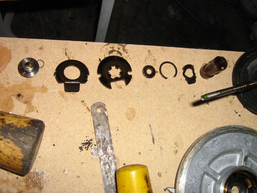

(IMG:http://i150.photobucket.com/albums/s92/chippievw/kkkturbo011.jpg)
after its removed, pull out main shaft from the far side, it just slides out.
at that point the spacer and main bush can be removed, push main bush up to yourself from below it just slides out.
and heres what you should be left with, all in order, the next steps are to clean everything, and refit/inspect seals and bushings for wear, ill be fitting new bush/seal kit when i have everything cleaned up.
